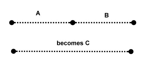

The question of the day : say I draw a line then another one with SHIFT
so they are aligned with 3 vertex points inside (maybe 4 ? )
Does exist a notion of "merging" for have only One line so with just Start & End points ?

What do you mean by "aligned with 3 vertex points inside"?
If you start a line or bezier, snapped to another tool, it will analyze where you snapped it on and provide a tangent as orientation vector. Holding shift allows you to lock to the tangent or any 90 degree (45 on some) step around it as you change your direction during dragging, while it also offers to lock to compass steps (canvas coordinates).
You may snap to any location on a line, bezier, circle or arc and get the corresponding tangent from that place. If you wish to consider this tangent to have 2 points and then consider your new line (or curve) to start also with 2 points, then you would have 4 points that compute their relationship.
YES, the notion exists to have merge. Not only for lines, but also for patternpiece polygons. It's not possible to merge Beziers, unless I introduce Splines, but I currently don't have that notion, because it is not necessary and only complicates things for no reason. But, yes, merging lines that are in a straight line or polygons that share an edge is definitely on the table! :ob

Sorry i have forgotten to send image! With image all is more clear in a glance! :beer:
2 lines A & B "connected" by the SHIFT alignement
so C yet on the table or out the table? (for the current version that I have) :)

Oh, yes, yes, I did understand. ;)
It's not in there, yet, but may come.
Whereby, it's not exactly true. In fact, it is already happening, when you do a dart transfer or when you add seam allowance. Both have routines in them, which merge lines that are connected and point into the same direction.

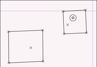

Another thing : when you call the "Move Point" they are lovely orthogonal lines around this special cursor
But as soon as you Click a point for move it they disapears! :o
Will be more useful if they can existing all the use of the function "Move"!
Post Sat May 09, 2020 1:31 pm
Re: White Rabbit CAD
Oh, we totally did that on purpose, because a pattern gets pretty dense with lines and it could get very confusing during moving. It provides a good orientation around the move action. I could, however, imagine this might make an interesting settings parameter: "Move Point Guides Always On", or so...naming is always challenging.
