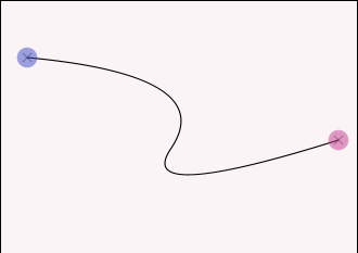

Trivial curious question :)
Say I draw a Spline -Subdivide - Split
Does it possible to transform a curve (segmented) in a Spline ?
Seems there is a bug...When I SPlit a Bezier curve in "3"
a cross appaers in the middle when i press Split! So I have not 3 parts but "4" !!!
The little curve that I move is not 1/3 of the initial curve! :)
sure i can take the 2 little parts but they are not merged! (how to merge them ? )
And as want this third part as New Bezier (if possible of course) I am perplex! :)

Yes, Pilou, that's a funny problem with the "Tailor" curves. They are really 2 quadratic Beziers. You cannot really reconstruct the center piece, if you split it by odd segments or, well, if you split around the center. It's an issue I'm keenly aware of, but should not be dramatic. It's just good to be aware of it, that's all. :ugeek:
You will not have that phenomenon, if you use Cubic Beziers! ;)

An elegant (?) solution for the tailor 3 parts Split :)
Draw any Tailor Spline
Select it - show in the Bezier Info if Length is 3 divisible
If yes continue, if not enter a near 3 Length divisible :idea:
Subdivide
Start Location input Length / 3 then Split
select second part
End Location input Length / 3 or middle part then Split
et voilà! :roll:
