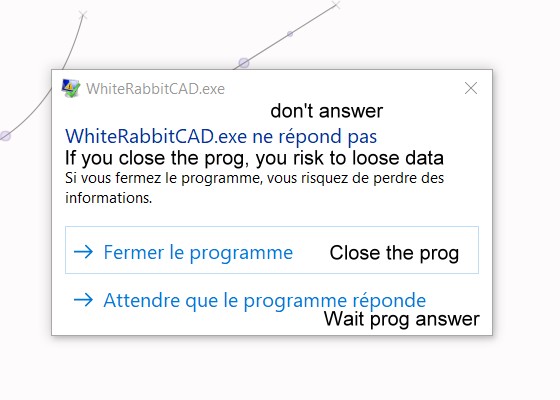

I make my elegant solution above :) so only one Tailor Bezier so 3 curves resulted.
then draw another Tailor Spline : show the Bezier info box and Input a value that glitch!!!
It's typic of One Shoot function! :beer:
Another try (new White Rabbit session )
I draw a Tailor Spline any size
input a value for be divisible by 3 OK :ob
I draw another Tailor Spline info say 23.03 so i enter 24
23.03 stay ! (bad sign) :shock: i enter again 24 frezze... :roll:
etc...
Five sessions different and at each time this freezzing it's i call a repeatable bug! ;)
i will see with another functions...
for help you here the freezzing message!

I don't know what I'm doing, because I can't get that at all?!
I make a Tailor Bezier, about 54cm, then set it to 55 to have it divisible by 3. Then I add another Tailor snapped to the last and make it 23cm, then set it to 24. No problems?! And I then tried every conceivable combination. Problem is, I couldn't even imagine why it would fail, if I did understand your description!? :shrug:

Can you try to record it?

55 is not divisible by 3 ;)
But i believe it's not aespecially the 3 division ...just draw a spline ... enter number... then draw a second spline...enter number it's here the blockage!!!
it's the enter of numeric number inside the box who perturbate the prog!
it want not certain enter for re calculate the Spline!
Have you shown the message error above don't know if that help you ? Except that proove that i did't dreamed! ;)

I have a Tailor Spline curve 18.02 length and want input 18.03
Stay on 18.02 but this time don't freeze!
Is that the same for you ?

Have you bent it already, or have you kept it straight?
Because this length will only do anything, if you already have the curve bent. If you give a length that is shorter than the straight line, it will revert to the length of the straight line!
But no matter what I do, it never freezes.

In fact no if you draw a straight Line you can't ask bigger it's stay at the Start Straight line!
But you move even a very little move the general handle you can ask any Length :)

The mystery is why that block at home ?
Maybe the fact to recalculate without a refresh somewhere ?
Or an armoredless numeric enter ?
or...
