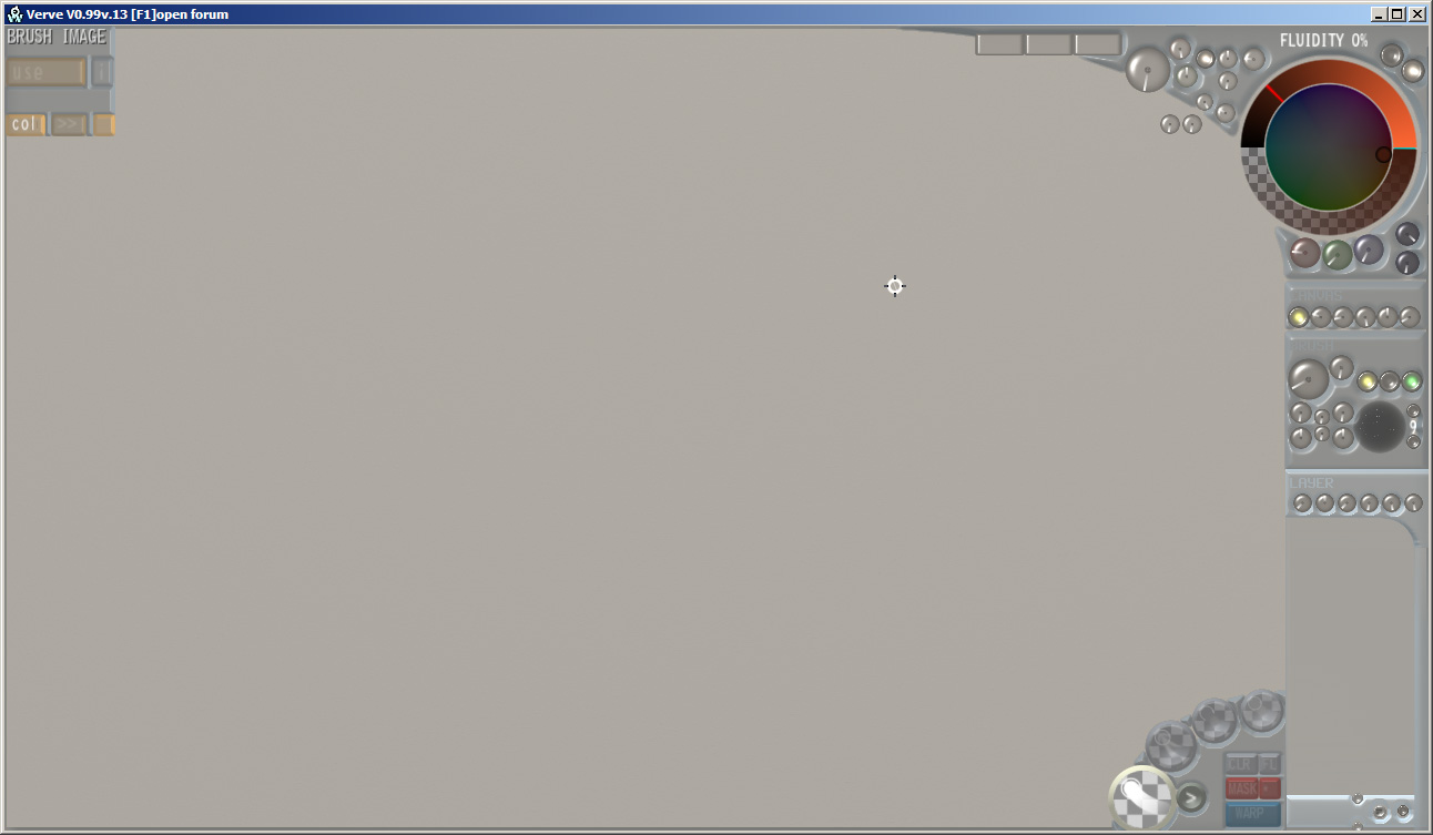

Minimum System Requirements: Windows PC, that's the only thing I'm sure about, but OpenGL 2.1 should be supported as the whole thing is GL shader based. Plenty of graphics memory is helpful, too. I'd imagine Intel onboard gfx cards on laptops might not work. I recommend Nvidia or Ati no older than 4 years, as dumb as I might sound saying that. Let me know, if you have any troubles, please! :geek:
It's recommendable to install Drivers | Wacom, even if you only use a mouse.
It should start up looking like this (just bigger and probably more features. This was v0.99v.13):
If the color picker or any of the interface does not show, we're in trouble. :(
Ati may have a bit of a different look (sloppy mess)... :| ...machines older than 2009 will have all sorts of troubles.
FINALLY with Version 0.8 there is an interface, while some functions are still hidden and only reachable through HotKeys.
