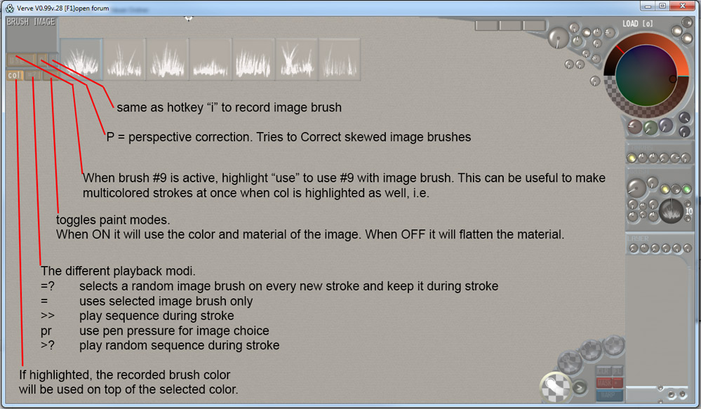

Image Brush Part 4 - Image Brush Menu
This picture tries to explain the image brush menu, as far I know it.

BRUSH IMAGES (image brush)
Currently brush images are just experimental and work with brush #9 and #0.
Brush images are like animation frames. You can keep adding images and they will playback as you paint. There is no management for them, yet, but you can save and load your brush image sequences already!
Please, be patient and careful when you operate the hotkeys, not because there's any problem with it, but because it's a little weird. There are no indicators for modes or any stuff that one should expect, yet, so it's all very, very "garage" or "laboratory"...but still enjoyable, hehe, you may see!? ;)
[i] to add new brush image and toggle on brush image edit. It opens a little rectangular selector. More on that one further down!
[Ctrl]+[Shift]+[i] toggles color mode, either using the original colors of the images, tinted by current color, or only use current color, ignoring image colors.
brush image edit ACTIVE:
[Shift]+[i] deletes only the previous image. [don't ask, I wasn't done, yet!] :shrug:
[Ctrl]+[i] paste currently active brush image. [all just remains of my tests] :geek:
[j] toggles perspective transformation on/off, approximating the perspective of the image taken as suggested by your selector rectangle.
Hoover over an image and CTRL+LMB click to delete exact this picture
brush image edit OFF:
[Shift]+[i] to delete all images. [all still temporary] :?
[Ctrl]+[i] toggles paint modes. When ON it will use the color and material of the image. When OFF it will flatten the material. Using Average when OFF works like standard Average blending. When ON Average samples the color in the center of the brush and paints the complete image tinted by that color!
brushes that use images:
Brush #9 with images... well, you'll see, it will just paint with the image spread across the bristles. (Crazy fun, if you know what you're doing!)
Brush #0 only works with images. If there is no image, it will not draw anything!!! The little brush interface dials will do very specific things to this brush. Go explore, hehe! I'll explain more later, I promise!

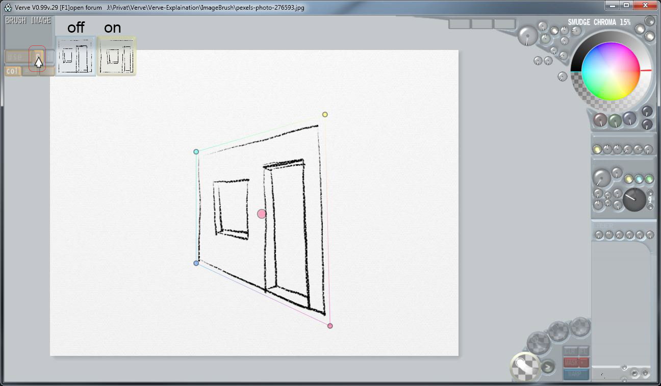

p - "really no idea" :hihi: ...that's the PERSPECTIVE CORRECTION feature. If your image capture frame is skewed, turning [p] on will try to assume the perspective it has and straighten out the content of the frame.
For example, take a picture of a house or a cityscape and fit the frame around one side of the building that is nicely in perspective. Then toggle p on and off and see what happens to the preview.
While you currently can only change this when you snap the image and once you snap a new image, you can't turn [p] off on the old one. BUT this is actually only a GUI access shortcoming, because in reality you can always change it as the original data is stored. So...yeah... anyway!
Try it out, it's pretty amazing! I've created this routine almost as a challenge to photoshop, hahaha! :ugeek: :P

Image Brush Perspective correction
Here is an example on how perspective correction in image brush works:
