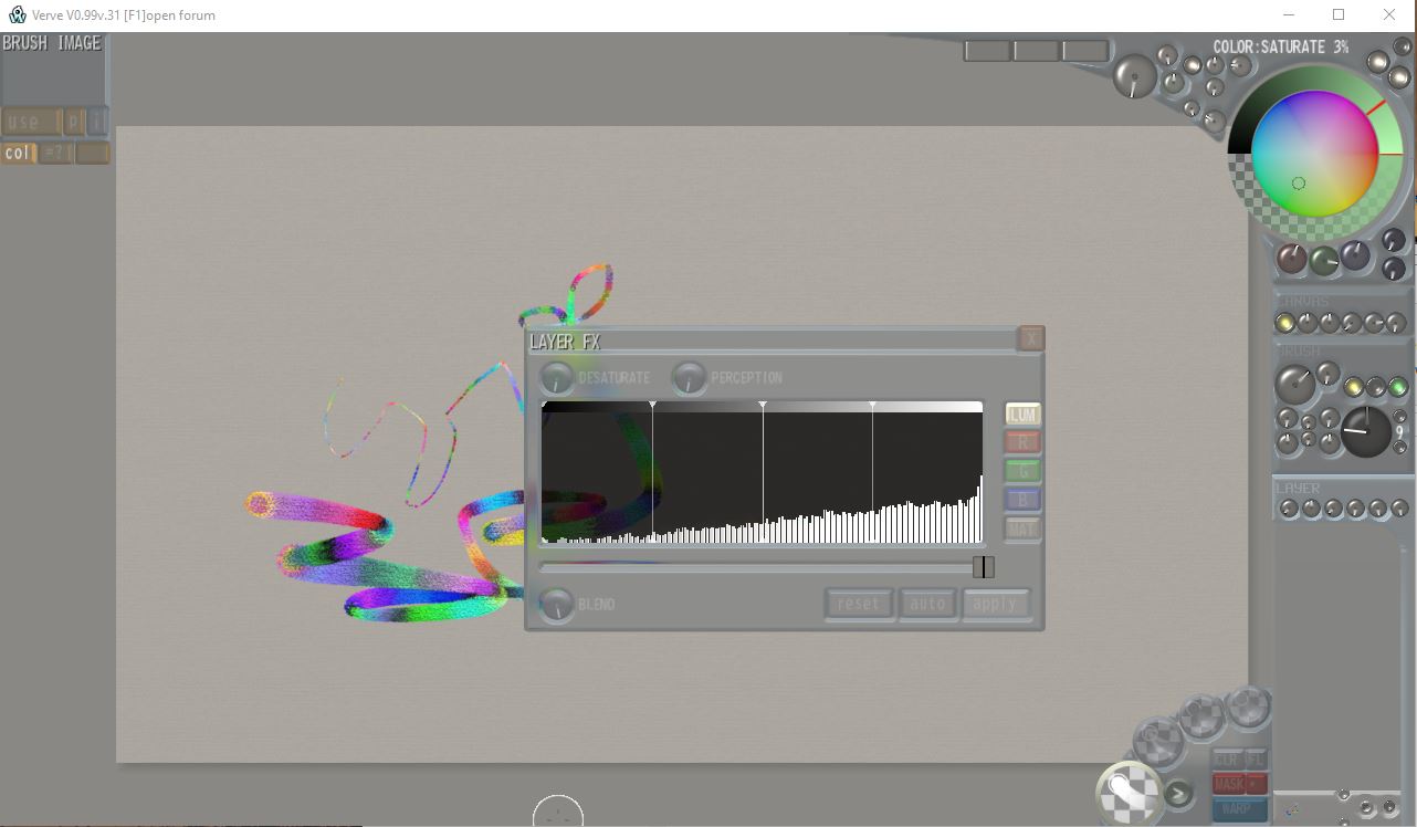

I forgot to mention if I close LayerFX dialog on empty canvas Verve colors are back in normal state.

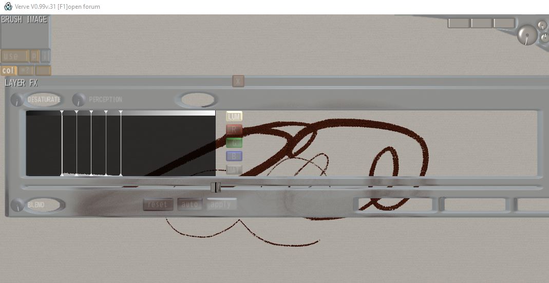

That is wicked?!? :shock:
I can't even imagine how it comes to number 2. :shrug: ...how?!
I mean, what makes this card decide to draw the GUI at twice the width, or whatever is happening there?!? :o ...I don't understand. Stay away from ATI, honestly, because that is spooky shit. :uhuhuh:

Sorry, I confused you little bit. My last contribution just meant that if I close the dialog then everything works correctly as before dialog and black color is away. So of course it is correct behaviour. :-)
Don´t worry about that. Layer FX works VERY well with something on canvas - and this is reason of the dialog. There is no need to fight with a little ATI bug I mentioned.
Auto button is very useful and works! :rock:

Thanks, Lemi! This strangely stretched GUI spooks me, though. I wonder, if it's some GL trouble with Viewport or so... just doesn't quite make sense to me, you know. Puzzling, yet, interesting and very, very scary. :shock:
I could do a little check, though, to make sure it just doesn't do anything, if there's nothing on the canvas. This could help prevent unnecessary shockers. 8-)

I've uploaded a small "fix", Lemi. You could try this and see what happens! :geek:

Ha, the black issue has gone! But there is still "stretch" issue. If I run ctrl+L, close dialog using cross button, ctrl + L - all works correctly. If I run ctrl + L, press ctrl + L again, dialog is closed ok, ctrl + L again - dialog is stretched!

OH YES, I have that, too!!! That's wicked! I will check! And I apologize to ATi at this point! :oops: :lol: ...has nothing to do with the card! I should regain control of my impulses! :?
