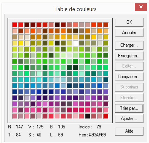

Say i want to use this table (my SPecific Windows Palette ".PAL" 256 colors
What was the best way for include it inside the Swatch system ?
If I don't want make 2562 clicks! ;) (even I become more and more confortable with your Swatch colors folders system! :geek:

Seems you miss the previous posts : so here the file".PAL" :)
About the explanation : just that my 2D prog manages easily any image palett (millions to 256 colors) (many classify...etc)
so i wish reuse this 256 colors palett in Verve! 256 colors are sufficient for my old eyes! ;)
The file .PAL is the result of this palette image! ;)
Found on the Net

Nope, I did not miss that post, but it doesn't seem to be the same pallet!
(I've got import working already and just want to make sure I'm doing it right!)

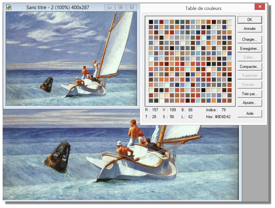

The Table square palett 256 shown above was classified by Tints
An another specific one will be this table etc...
By E Hopper ;)

Paint Shop Pro .pal format (JASC-PAL) is already working just fine!
UH, thank you, Pilou, yeah, seems like I ALMOST have the RIFF PAL right, too. I somehow must skip the first color somehow, haha... should be easy to find.
In about half an hour I will have a version that imports both those formats for swatches! ;)
