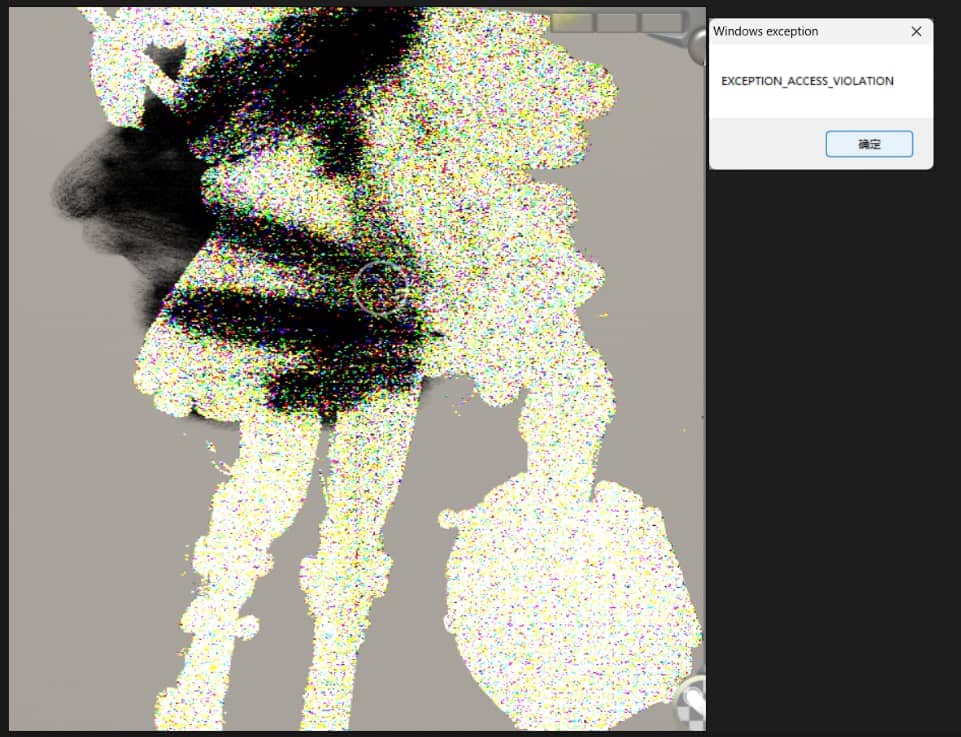

Post Fri Nov 22, 2024 4:31 pm
Re: Strange bug that makes Verve unusable
Hello Taron, I have encountered some problems.
first, the canvas resolution can not exceed 5000*5000, once it exceeds the save file will have problems.
Second, when I open the file I get a corrupted screen like this and it crashes when I save it.
This is my PC configuration:
win11
CPU R5 7600X 32G
GPU AMD6800 16G
I'm using version v0.99Z.
By the way, I was able to open it on a cloud computer with a 12700K 4070 configuration which confused me .
Post Sat Nov 23, 2024 7:35 am
Pfff, yeah... well, thing is, Verve still is only a 32bit application. This means that certain file sizes exceed what it's capable of handling. Unfortunately the programming environment of it never allowed to go 64bit, which is why I have planned to switch to another, but in the meantime focus on developing Vervette, which runs in the browser and is therefore completely cross-platform. The version of it that is out there still is ancient by now and does in no way reflect where I am with it now. My development version of Vervette uses the full color depth of the GPU and theoretically could handle any resolution, though I still have to optimize things for that to be realistic on really high resolutions. Anyway, it will clearly surpass Verve. However, I still want to resume Verve as well, but it will be a major rewrite. Essentially a new software altogether. We shall see about that!
So, yeah, I'm really sorry. Wished I could tell you something smarter than "try to keep it smaller than 5k". While I absolutely understand the wish for such resolutions, Verve was just never conceived with the idea to go that big. But you guys really push me hard, hehe... excellent! :ob :PP ...I continue to try and make it possible! :geek:
:beer:
Addon: I've just tested 5k by 5k in my dev version of Vervette and it actually handles it shockingly well on my old, basic Mac Mini M1. Saving and loading, too, while it's a 331Mb file, ugh! :shock: ...but it's fairly quick to save and load, considering. About 26 seconds for saving. 7 seconds to load.
