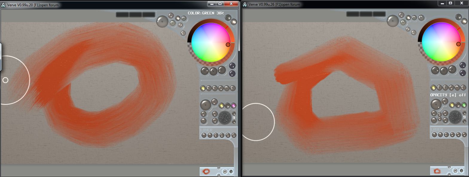

Ive been playing with the most recent version and I noticed it feels more sluggish and it is creating those straight lines when drawing the stroke.
I tested older version u20 with same settings and it is much smoother...no straight lines in stroke. See attachment.
I have mixed feelings about the new fluid behaviour....not that its better or worse...just that its different
especially when you crank the fluids and use it more like inks.

left is V 20 right is V26

Ah yeah, that's interesting. I'm sure some of the stuff I've added would require more computation, while at the same time I've eased the burden on others. I am constantly going through everything and every step forward is really just something that widens the spectrum of what I can incorporate eventually.
You should try to turn the canvas off and tell me, if u.26 is still more sluggish than u.20 then?!
BUT it may not even be the fluids, but the brush 9 that causes it to be slower, depending on the rest of your machine specs. Just try it with brush2 to compare the versions!
However, a key aspect of the new fluids is that they are "more correct" in the texture interaction. That's rather exciting, because it slowly suggests a chance for a healthy paint on paint interaction, hehe. ;)
There are a number of things that will benefit from what I've figured out, you'll see.
The other thing is, the more "accurate" things are supposed to get, the more speed will have to suffer. My fluids, for example, permit leaping over several pixels with their velocity. Really accurate fluids could not do that, because vital interactions between point A and B would have to be processed properly and propagated into the rest of the fluid space. SOoooo it'll never be completely accurate, but it'll also be far more artist friendly than anything that would be. I've seen MoXi, for example, and the new thing from the maker of it, and it is beautiful, but it is slow as heck. You basically have to mediate and enjoy watching water soak into paper...it won't ever be anything like Verve, I'm quite sure. I could consider hooking up modes that would support such accuracy, but I have a feeling it won't be used all that much. But who knows?!
There's one more thing that could actually affect the speed. I'm not doing event based input, which is very different to what I used to do. I'm not yet entirely happy about it, because on my wacom it feels like the brush can hang and keep painting without pressure, which shouldn't be possible at all. Not sure what black magic goes on there, but sense it makes none. Anyway...it's another potential slowdown.
