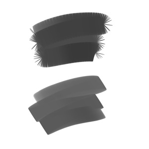

I really think it could work well. I've attached a picture from Photoshop showing a brush using direction, and then the same stroke using initial direction. The direction version has the exact same flipping issue that you are having. Actually, the flipping creates some nice randomness to strokes that sometimes is desired, so I think there is a place for both methods.

...and ROFL :lol: :bounce: on Photoshop screwing it up, too, hahaha...that's unexpected. Guess the major difference there is that it does that a lot slower, haha! :twisted: :lol:
