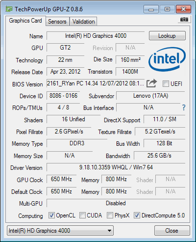

GPU-Z output:
GPU-Z output
Shader model: vs5.0, ps5.0
