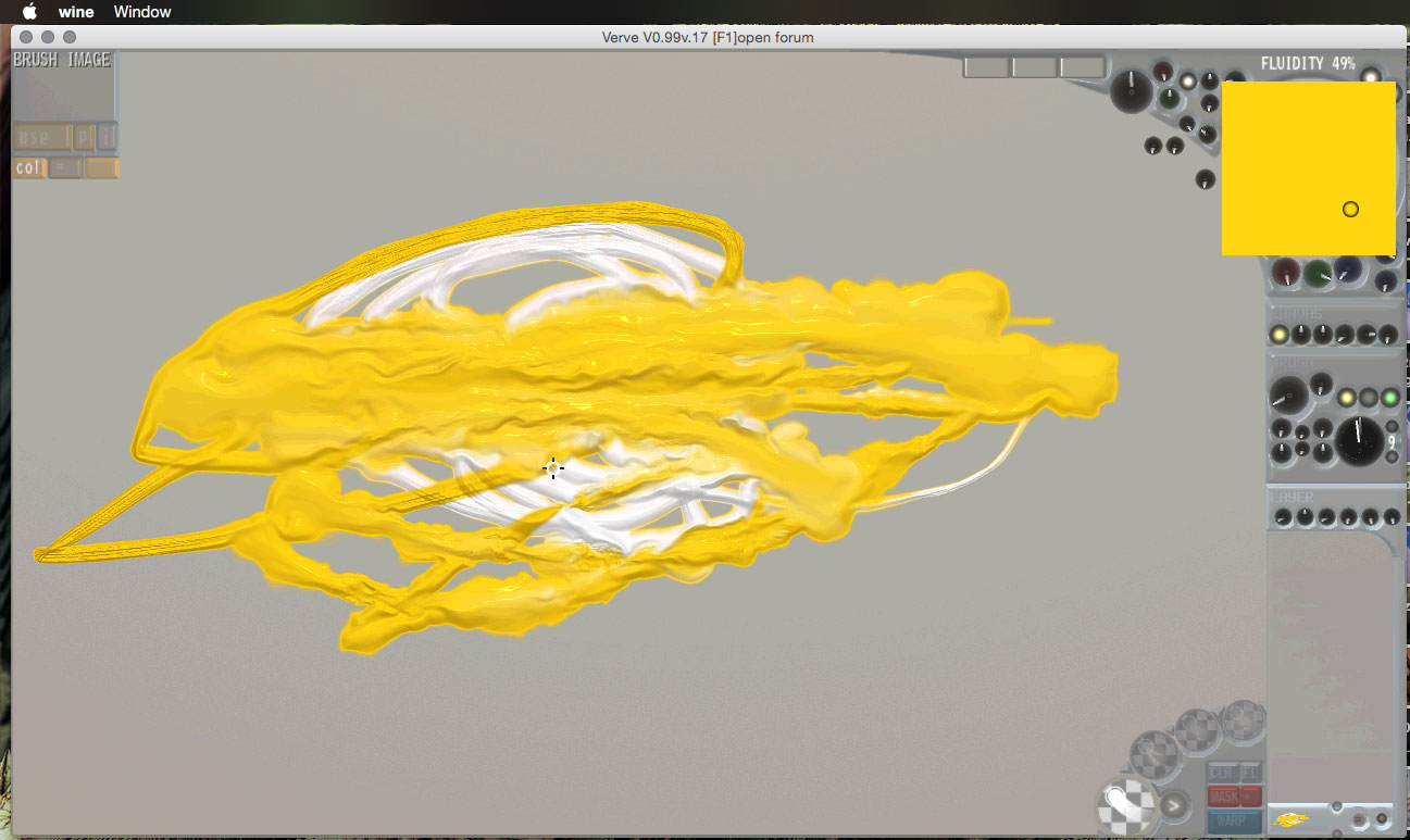

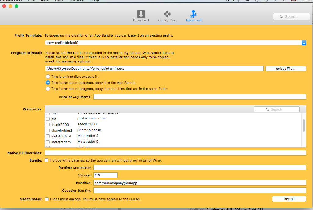

I tried this but when I open the wrapped Verve i get mostly black interface which does not work.
Can you PLEASE PLEASE PLEASE clarify and specify what you did and how you did it?
Versions, Wine, OS, Settings....etc
This is HUGE if most of use can get it working!!!!!
Thanks sooooo much!
Screen Shot 2016-03-05 at 1.23.12 AM.png (127.79 KiB) Viewed 25624 times
Screen Shot 2016-03-05 at 1.22.20 AM.png (131.03 KiB) Viewed 25624 times

Here's a screenshot.
To get it to work, I used the winetrick that set windows version at 7, and allowed wine to update itself the first time I launched the app (make sure you update wine to the latest version as well, since they're always improving it). I also had to install the latest version of Quartz/x11. Additionally, I set the option to bundle the wine binaries inside the APP. Other than that, nothing. Only issue I have so far is that the color picker is one solid box and it covers up some of the dials. Performance seems to be fine so far too. I'm not on El Capitan, so I can't attest if it works on that.

Yes, a bunch of those shaders don't seem to work, but it's really hard to tell. The knobs should be transparent with a bump on them, but they just look black, for example. I'm almost surprised that the paint looks kind of fine.
