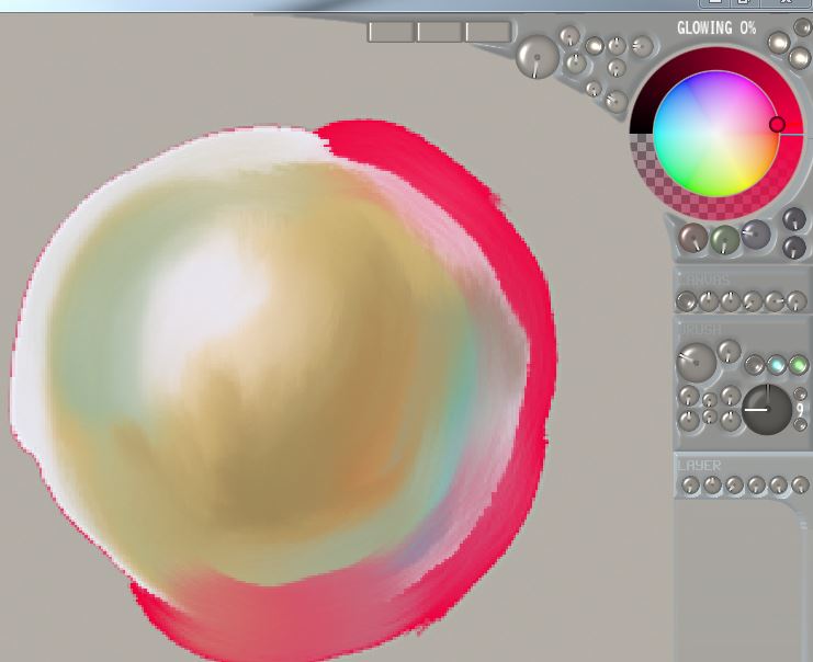

Hi,
after a long, relaxing break, I touched verve again, today.
But after a minute I already stepped into the most annoying "bug" verve had from the very beginning i started using it.
The way verve handles unpainted alpha space while smudging - averaging- blending.
Instead of mixing with alphas opacity and color, verve uses the actual selected color.
This is unlogical and unexpected, like a bug. No matter what technical reason.
I am quite sure, that this behaviour ends in the black bug worst case.
Just a guesstimation - it lies in the fact that smudging, blending and averaging (CTRL+SHIFT) uses the active canvas colors and the selected color, but not really the alpha.
I.e. If there is 50% color and 50% alpha under the brush tips canvas, verve still uses the selected color to mix with - even when it's opacity is set on 0.
Strange.
This is such a pity as it makes one of the biggest advantages in digital painting less useful for verve - using layers to add details and smudge and blend them with alpha.
The only "workaround" I know to get decent smudging and averaging is to fill the canvas first, which is not a real workaround at all.
Anything else one can do to avoid this?
If there is technically no other solution than a switch to ignore selected color for smudging, blending etc. I would really appreciate this function.
Honestly a fix would be the best.

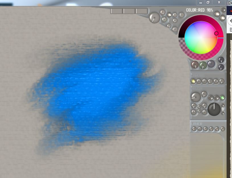

Post Wed Jun 20, 2018 10:28 pm
Re: Alpha Smudge - Average - Blending Bug / workarounds?
Taron wrote:I thought about something like that, but it would be quite awkward and possibly choppy. Blending, essentially is doing that and also shows the performance it represents. What bothers me is that it isn't really a solution. I'll keep pondering over it, but it must not be a work-around, I think.
What surprises me with blending is now, that it reacts exactly the same way concerning alpha@0.
Put opacity on 0, blending on max and the alpha at 0 area is flushed by selected color.
But with color picking the border color while smudging, blending and averaging along alpha=0 areas I can work quite well. ;)
If one knows how it works, it can be even fun to use it for adding slightly another color while smudging.
EDIT:
Another workaround is to fill (CTRL+SHIFT+F) the canvas with black and opacity @ almost 0. One have to play around with that. Already a very low opacity is damping the "flush by picked color" effect.
A bit more let it completely disappear for a very low (almost invisible) price of grey dust on top.
It then smudges to slightly grey.
Play around and fill with low opacity white instead.
Works even more neutral, I guess. Still testing.
Ahh, sorry, know you'll have a dark border to alpha. Maybe filling is not THE solution, but black is the better choice.
:beer:
