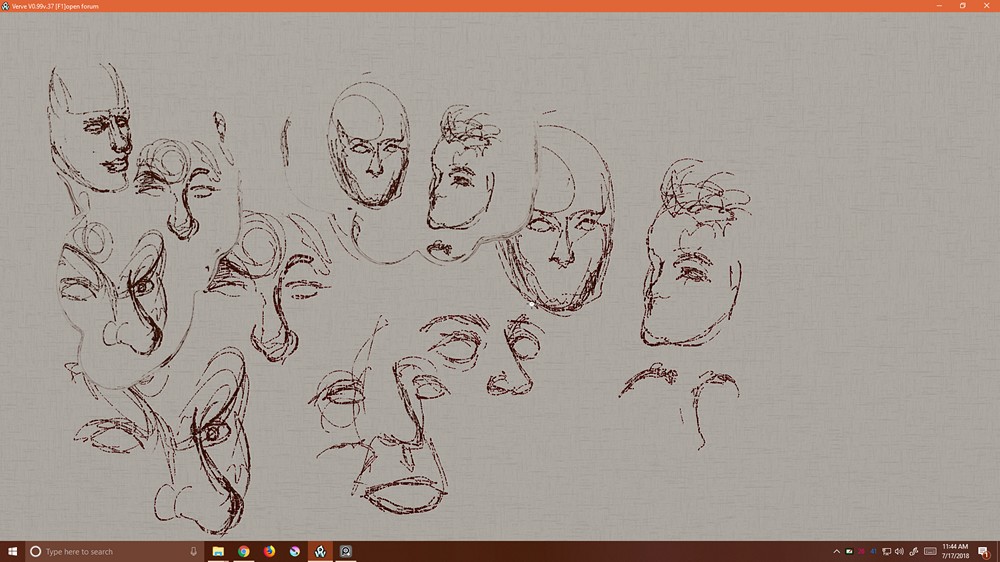

I do have what seems to be a new bug in v37 to report. The old ability to 'erase' in warping mode now produces... weirdness. More precisely, it seems to uncover a copied layer which has been shrunk and scooted to the upper-left:
Screenshot (4).jpg (131.08 KiB) Viewed 40911 times
This was simply holding CTRL with brush #6 in warp mode, on a single layer. I regret forgetting to leave the toggle panel open before screenshotting, but I think it was all defaults.

GREAT! But I can't report any changes to Warp and find nothing different in a quick test either. Maybe something got a little confused? I'll have to do more experimenting, but I can assure you that I've changed nothing on that as far as I'm aware. BUT one never knows... so... THANK YOU for the report already!!! :ob :beer:
Post Tue Jul 17, 2018 8:46 pm
Re: feedback v37
Just a little explanation on the side: "Erase" in Warp Mode relaxes the coordinates! It doesn't "erase" something, but simply gradually brings the UV coordinates back to their original values. As a result you can have the same UV coordinates in various places, creating the impression as if there were several copies or instances of the same space or drawing. Keep "erasing" and you'll see how they gradually pull back to their original layout. Soooo, I think this is merely a misunderstanding and want to assure you that nothing has changed for warp. ;)
