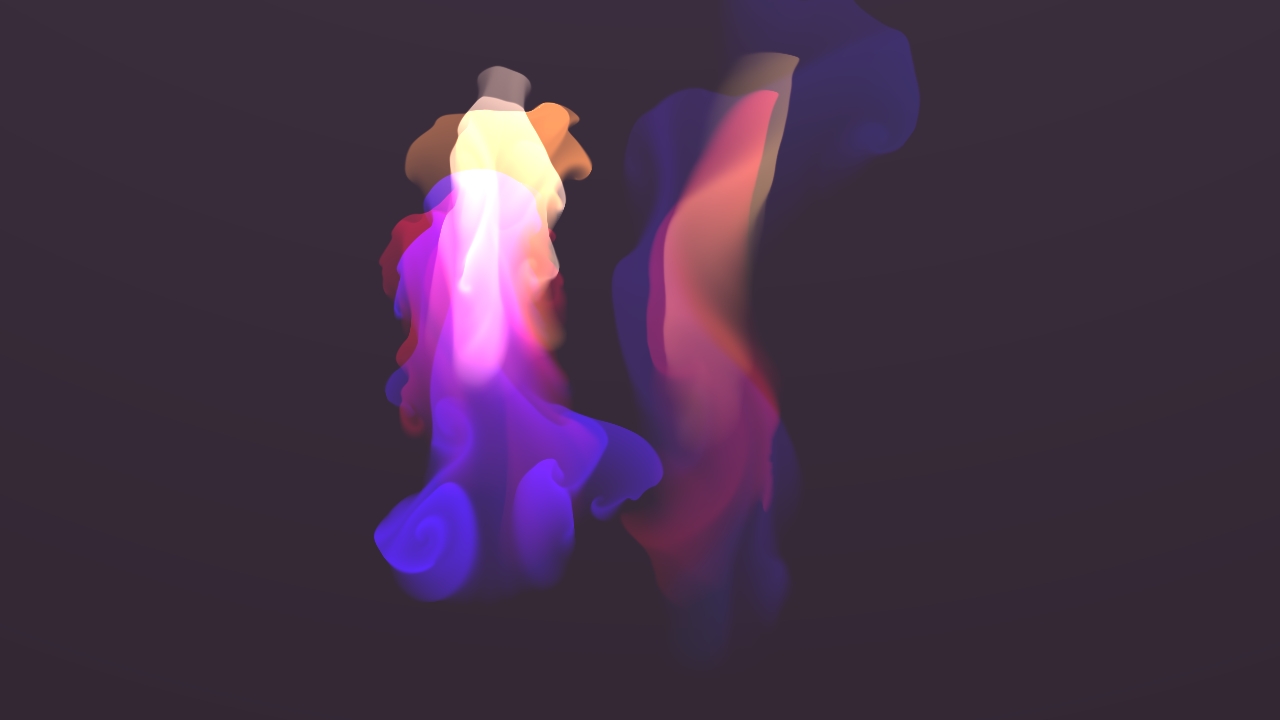

First, make a brush that can launch some runny paint.
Turn Drying OFF
Build Up 100%
Fluid Smudge 0%
Fluid Sharpness 100%
Fluidity 100%
Then make multiple layers and set to additive mode.
Go to the bottom layer,
Stab the canvas with dark blue and use an upward twitch to launch the paint skywards. Let the paint bleed on its own.
Switch to the layer above to freeze the simulation when the paint has spread far enough.
Switch to a deep red and repeat the stab/twitch movement at a higher level.
Then repeat the process with orange and pale yellow.
Posts: 7456
Post Sat Mar 15, 2014 3:10 am
Re: moatdd mucks around
Wahaha, that's a nice idea! Good one, moatdd! You've got a health tutorial-making obsession, I like it. :D

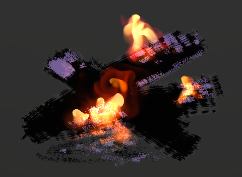

Making really good use of the "D" Drying Toggle function to "brake" (not break) the flow of the fluid simulation.
Also using the CTRL+LMB(eraser) to shove the sloshing paint and dig holes to make the fire flow around the logs.

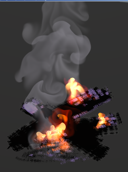

Ok, using SHIFT+LMB instead to stir up the runny fluids.
For smoke, make several stabs at the base of the fire (to get a big blob of paint going), then whisk it upwards with SHIFT+LMB
Try to scramble the top part of the smoke puff to simulate the increasing turbulence near the top.
You also want a big gap between puffs.
Try to keep the flow near the base of the flame fairly laminar.

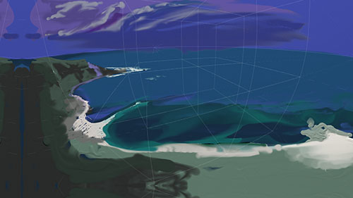

Last one for tonight. I really like that grid guide.
I kind of wish I could change the aspect ratio of the fluid vectors to match say, the ground plane on the box.
I should also probably try out some of the other brushes besides the single round one.
Posts: 7456
Post Sat Mar 15, 2014 10:49 am
Very cool, I really like that beach and how perfect you've used the grid. It feels big, the view!

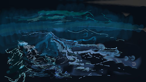

Ok, I think I got waves worked out rather well. (link goes to VRV file)
Brush 2 & 3 are gonna be your best friends in all of this.
2 is used for most of the heavy chunky shapes and lower layers of dark pooling. 3 is used with a low bristle count and size for the splashy stuff which I composite with additive layers.
