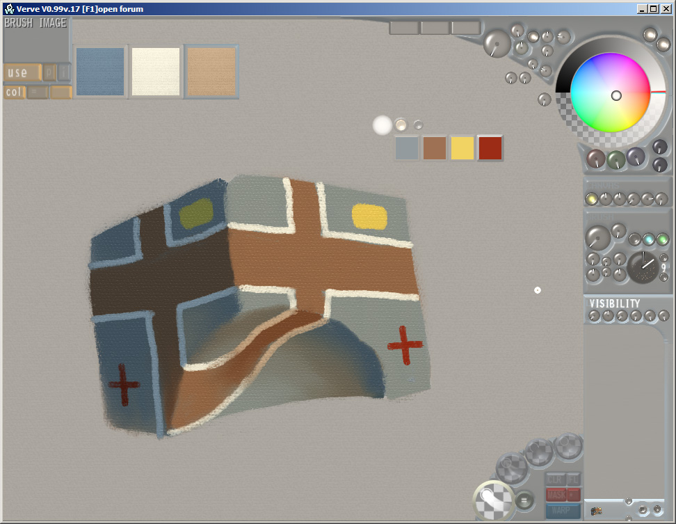

Here's an example for what I've meant up there:
USING BRUSH IMAGES AS LIGHTING COLOR MODIFIERS...
Here you can see three brush images: [SHADOW] [LIGHT] [BOUNCE LIGHT]
The color swatches show the colors used on the painted box, except the white I applied last to show my wife what this can do, hahaha. No other color had been used!

That looks great and so simple idea ! What are those floating colours on right ? I realized that + mode actually works like i want in that hue change suggestion cause when i pick different colour then it adds light towards this colour , same could be used for multiply mode and it would be perfect :)

Although unusual, this is actually an alternative that is, in a way, more traditional with bonus of simplicity.
After doing this I realized that it might be cool to have a color and a color modifier color. This could come in very handy.
Anyway, the floating colors are color swatches: [Shift]+[c] to toggle visibility of it. Check the docs for me info!

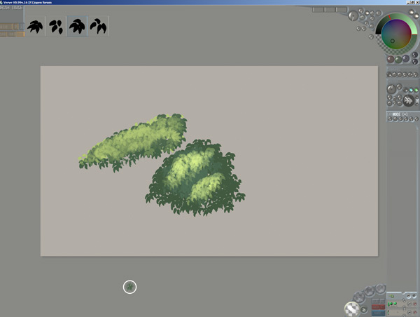

Regarding your very first question, have you seen the image brush collection?
http://www.taron.de/forum/viewtopic.php?p=14251#p14251
I made one leaf brush there. Even though I guess it's not directly your question, there are plenty of options to play with it to get what you are looking for.
Unzip and load it directly into verve. Use brush #10.
Ultra cool feature is that you can record multiple pictures and they will be played back during stroking like an animation. This avoids typical repetition.
Hidden features are:
Oscillate chaos over 180 is like scatter in PS.
Increase Bristles to paint more images by distance
Uncheck "col" to paint in the color you want, check col to paint in image picture.
I made a second leaf brush quickly.
Attached is the brush and the settings for verve. You can direct the leave orientation with your pen tilt.
increase bump to get very quick volume (carefully ;) ). Increase fluid & blend to give it a more "wet on wet" look.
Another option is to paint just single leafs. Top left window, beside col you can adjust if the images are played through, random or just the selected is used. With a bunch of leaf proxies you really have a lot of possibilities.
One demo with a bit more contrast.
And for sure you can create a bunch of different bristles too if you want to go more abstract ;)

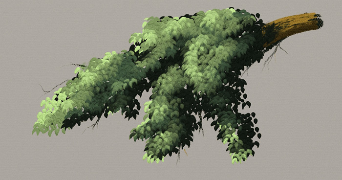

I've added USE of images for brush #2 and #3 as a little test. It's pretty amazing. Somewhere inside 5 seconds you make this canopy! c:!
...and I actually had the fluids slightly on when I was painting them. Those brushes react a little differently, which is really nice. :)
Attached is also the VRI with those leafs (leaves - spelling seems open on that one, haha). :shrug:

Wow taron, that looks convincing but bwwd brush is exactly what he was looking for, wasn't it?
Recording image brushes is sometimes better to turn off canvas, as you may double the effect later when painting again.
If your brush is fully opaque and you turn off transparency while drawing with the image brush, it will paint fully opaque.
I didn't do that in my example. It seems that you know that already, but maybe others are interested in the solution. ;)
Fluids and image brushes are a different story. I guess that the fluids are taken the motion vectors of this rotated and oscillated brushes.
It looks like they are thrown into the fluid and reacting a bit like that (Would be cool if they would really, adjustable splat btw.). Therefore just a minimum of fluid can make the edges unsharp.
